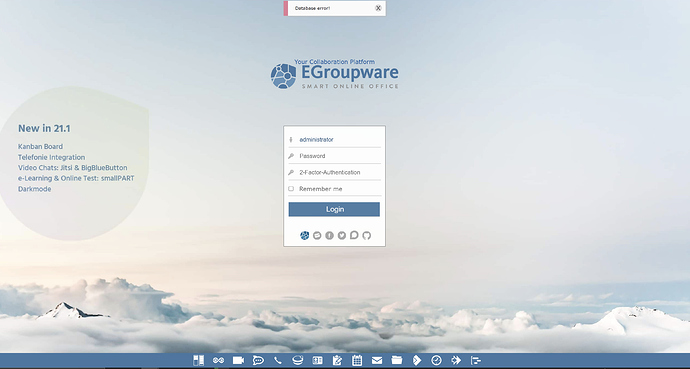

Version: egroupware-docker (21.1.20220916) After update/upgrade: Yes Error occurrance: upon login Reproducible: Yes Webserver error-log references: Yes Database: MySQl/MariaDB Webserver: nginx PHP within docker: PHP Version 7.4.30
*Screenshots and error-log attached SS0.png shows the error at login SS1.png shows the errors I get when I close my browser tab an then return to EGWegw_error-log.txt (106.1 KB)
Seems you uninstalled notifications app, and EGroupware does not deal well with that.
Go to setup (https://example.org/egroupware/setup/) upper login (credentials are in /var/lib/egroupware/egroupware-docker-install.log on the host), click on Manage Applications and install notifications app again.
Ralf
Mr. Becker, you are a gentleman and a scholar. Once again you were spot on, the problem is corrected. Thanks for all of your invaluable help!
